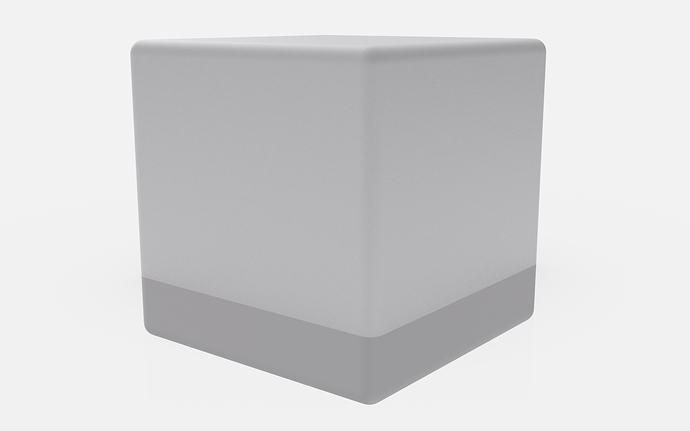

does anyone else have the same problem, that flakes are shown correctly in the real-time view, but once you start rendering, the geometry of the flakes goes back to its initial form?

No issues though with the flakes here so must be something else. I did see there was an option ‘flakes only’ and if you disable that option you will also see the cube again in render view. Not something you can change with render settings though.
And I saw your cube was going below the ground level so also tested if that might have caused it. No luck replicating your issue though. If you want, you can always send me a file for a check how/if it works here

Was using the newest driver for the graphic card (Studio and Game-Ready Option), with and without opzimization for Keyshot…even used an older version of the driver (September 2024 as recommended), but nothing. Still doesn’t render as flakes, but as a cube.
Rendering on CPU works though.
So I really don’t know what causes this issue.
The strange thing is that you do see them in real time view. If it would be something like too little VRAM or so that wouldn’t work as well.

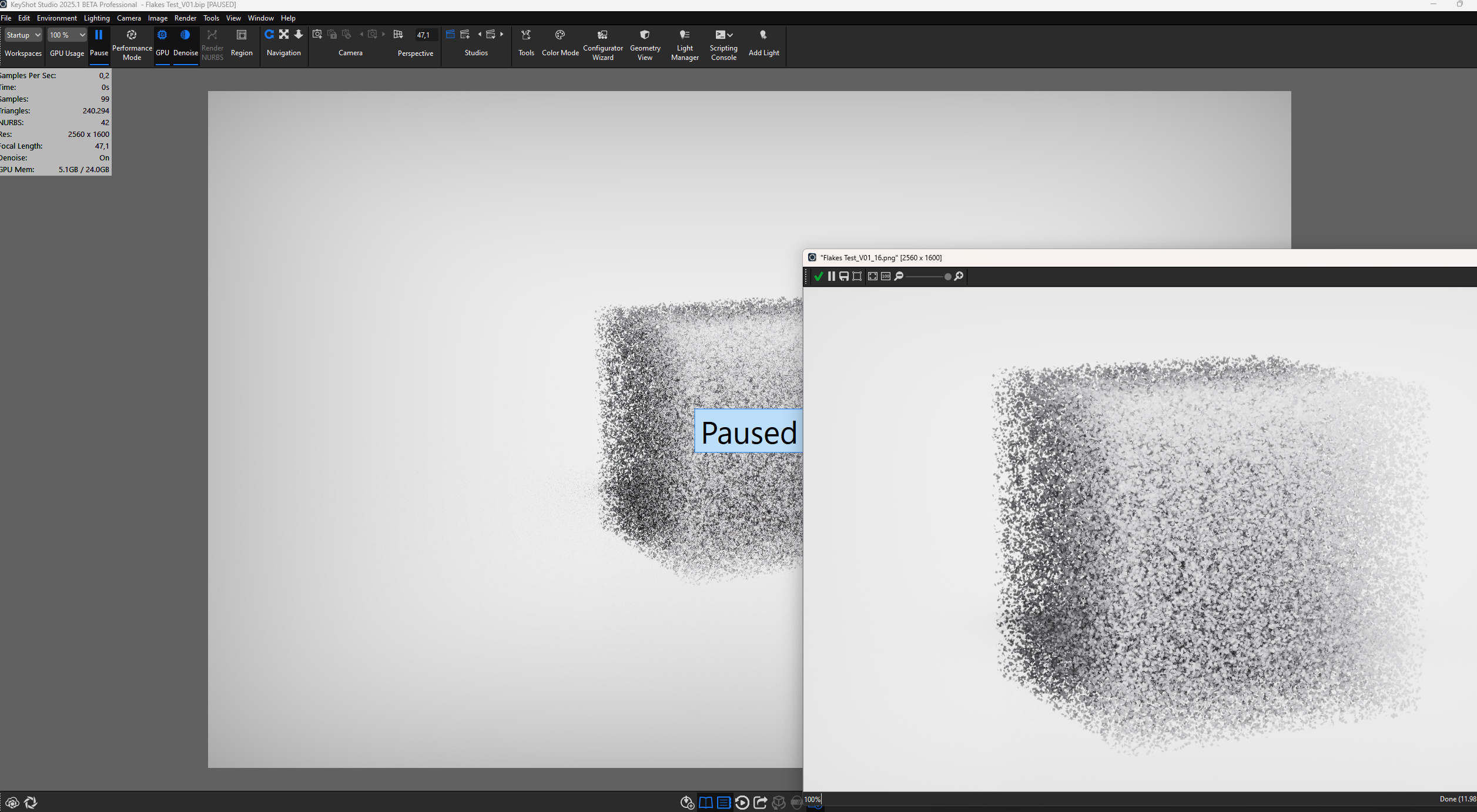

Oddly enough I had the same thing happen, but couldn’t repeat it…
I rendered an image on Friday where the flakes material didn’t render at all, when i rendered a second time it did it normally. I did not change any settings, literally just re-clicked the render button:

I have tried to replicate it this morning, I thought maybe having some of the flakes below the ground caused it after looking though your posts but I haven’t had any success in repeating it.
